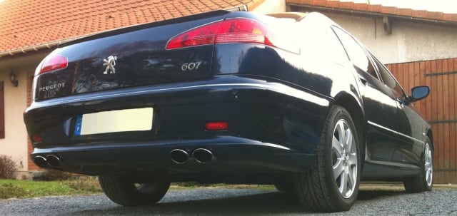

quelque photos
http://www.forum-peugeot.com/static/mesimages/43896/RTYRZT.png
[url]http://img15.hostingpics.net/pics/401228439448DSC0374.jpg[/URL]
