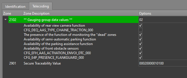

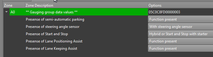

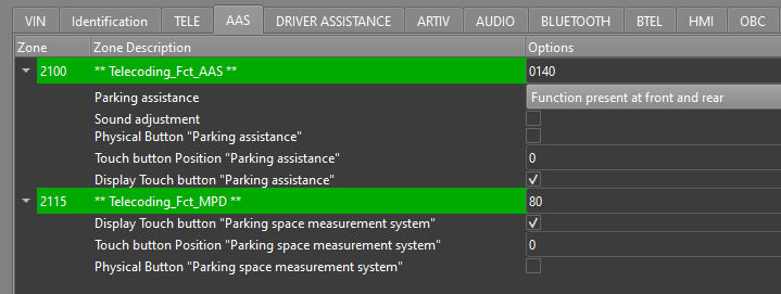

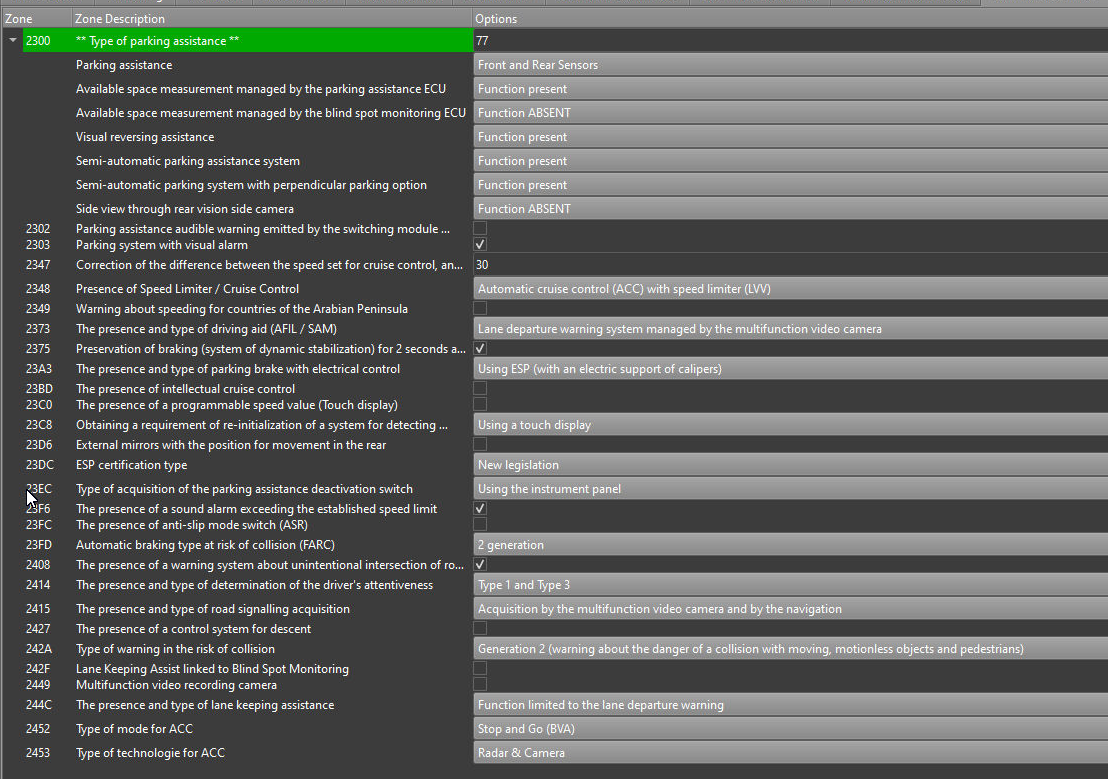

Hi, did anyone succeed in setting AAS_UDS_G5 for automatic parking? I coded everything, as far as I know, and it does not show in the menu on NAC, so I wonder if there are variants and I need to replace for ie. CKP variant?
Yes, I do have 12 sensor variants.
I did set it in:
dae bvh2 https://i.ibb.co/kVNM1Mbf/image.png
  • A0 - presence of semi-automatic parking = function present
NAC https://i.ibb.co/670MqTny/image.png
  • 2115 - Display Touch button "parking space measurement system" =✔️
  • 2115 - Touch button position "parking space measurement system" = 0
bsi https://i.ibb.co/C5XbrkhX/image.png
  • 2300 - semi-automatic parking assistance system = function present
  • 2300 - semi-automatic parking assistance system with perpendicular parking option = function present
  • 2300 - available space measurement by the lint spot monitoring ecu = function absent
  • 2300 - available space measurement by parking assistance ecu = function present
ESP90 https://i.ibb.co/CKfJPckm/image.png
  • 2101 - semi-automatic parking system = with semi-automatic parking system
ASS_UDS G5 https://i.ibb.co/606LM8Ks/image.png
  • 2102 - availability of semi-automatic parking function =✔️
  • 2102 - availability of parking assistance function =✔️

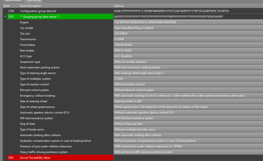

I do not have peugeot, but grandland x (phev), but it is pretty much same system as 3008, gauges I combine (which I like to have actual physical gauges) and I would like to try LPA, but for that I'm kinda screwed because I cannot access stellantis systems and get wiring diagrams. Can anyone here who has access to share wiring diagrams (but the ones like this https://i.ibb.co/rKBr1QQw/image-4.png) for
  • AFIL for Grandland X
  • LPA for Grandland
  • parking assist for DS7 (this is unrelated to grandland, but I would like to have physical parking assist button )
as I'm trying to figure out which wire is for which in this https://i.ibb.co/pBtSkxzL/populated.jpg connector - I did beep out the wires from the buttons I have and parking brake, but it is still mystery where LPA/AFIL would go.
Also if car with combine can even do LPA :)

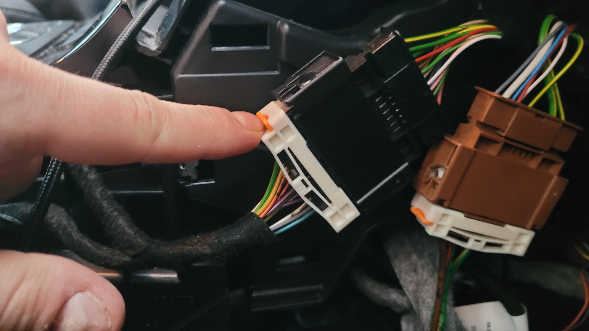

Update to my 180st camera situation ( https://www.forum-peugeot.com/Forum/threads/tuto-télécodage-et-calibration-dun-nac-rcc-cirocco-cmb_num-sans-diagbox-via-arduino.121767/page-196#post-2820245 )
I tried switching video + and video - connections and nothing.
Camera does provide image when set up as AVR instead of AVP and it does not provide correct image when i switch the video + and - cables. Car is set as NOT having AVP module ("360 module")
I also tried switching AAS GP to CKP G5, my car has 12 parking sensors, but no blindspot and I get
Notice it sill says AAS_UDS and not CKP_UDS, but i did not found separate CKP and AAS settings in BSI - is it possible taht for citipark i would need diferent kind of the 4 corner sensors?
EDIT: so I tried with cardboard box and even thought there 3 sensors in each corner two most on the side of the car do not register the box and nothing shows on the screen.
I do not understand if I need to change the wiring harness or where it is not connected. My endoscopic camera is quite crap and I was not able to see how it is connected now.
EDIT2: side sensors are connected
EDIT2: nothing is in pin1 and pin 4 of the green connector that does into CPK module
EDIT3: figured it out, even when car have 12 sensors (8 parking + 4 blindspots) and all are connected - it does not mean all signal lines are actually going to the parking module - crazy stuff https://i.ibb.co/p6hvDg7z/image.png - maybe someone doing same thing as me will find this helpful

I did manage to code ACC stop and go on grandland x phev. So it is possible.
Can you please post full log of ESP90 coding and csv read before and after coding?
Also some impossible configurations are rejected by the units, but it replies with the message that the writing was not success with code 7F2E31.

EDIT: found it. FYI when you are near an object and the sensors start beeping, there's a small button on the right top side of the screen, it allows you to adjust the volume of the beeps there.
