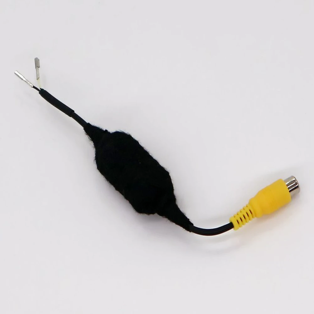

hello. I am trying to install a simple camera to my C4 Cactus 2018. I bought the following adapter:
https://ae01.alicdn.com/kf/H2d0ffb3...2008-3008-5008-C4-C5-Cactus.jpg_Q90.jpg_.webp
and a normal camera. Do you know any possible way in which i can activate the camera without buying a diagbox kit that is very expensive or going to the dealership? Also when i opened up to see the module, i saw that in the harness, the module A already had wiring for pins 16 and 17. I saw somewhere that not all the time it's required to code the BSI to see the camera. Is that true? Thanks
